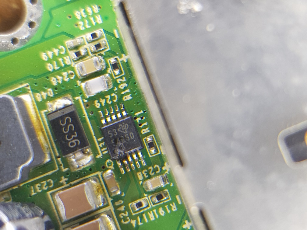

Hi, I hope to be in the exact section, I have this NVR under repair which is completely turned off.
I need to trace this component in smd, with burn marks.
On the net I tried to do some research but to no avail.
Thank you

TPS54260

amennone, примерь!
  TPS54260.rar  2.66 МБ  Скачано: 110 раз(а)
