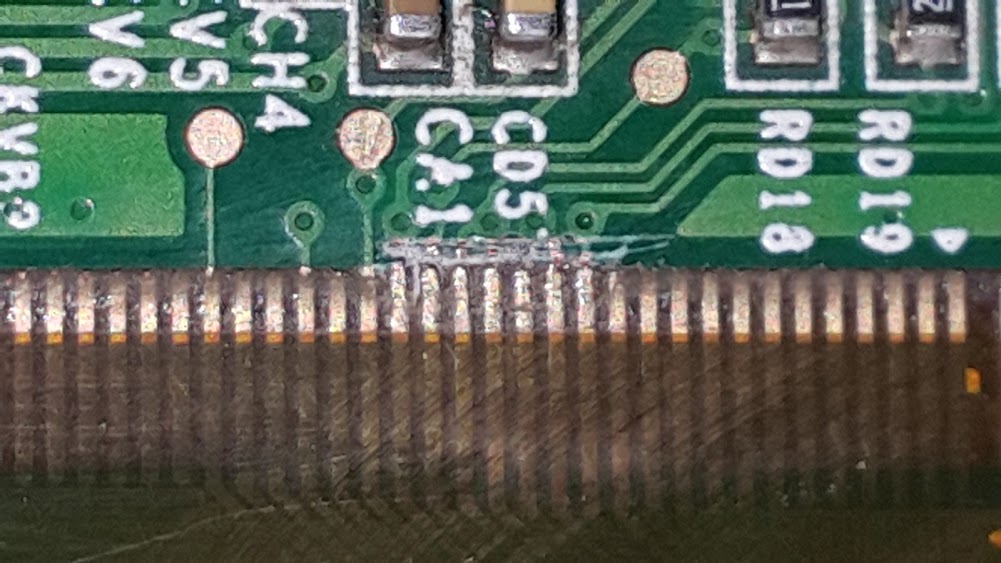

LTF320AP11,,,

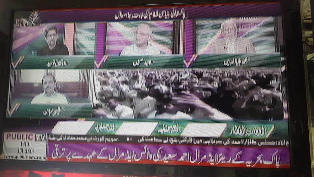

when firstly tv is on show the some vertical lines on top of the panel and after 10 or 20 minutes picture go faulty ,colors change and show the double image firstly i cut right side of panel
CKV1, CKVB1, CKV2, CKVB2 and STVP
but image show the half i am reconect the points, please help respected masters

Сообщение #2 от 29/05/2019 09:17 цитата
Not repairable. Finish.
