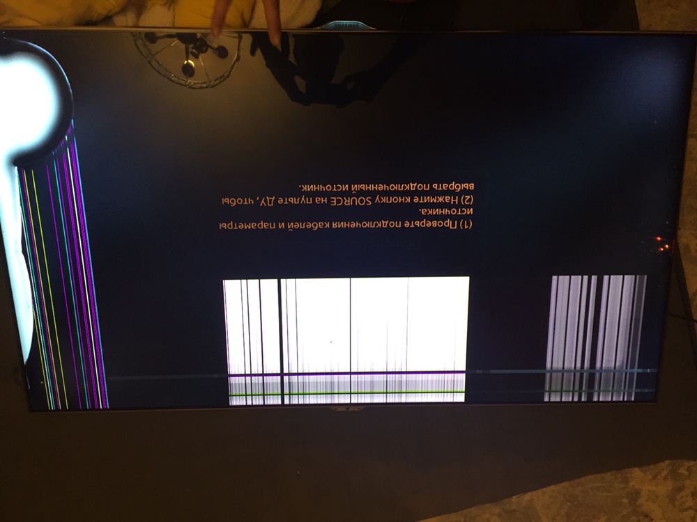

Samsung UE55ES8000S (Разборка, битая матрица)
sofserg1984
Сообщения: 36
Сообщение #1 От 05/01/2019 02:31 цитата
SAMSUNG LED
Model: UE55ES8000S UE55ES8000
Panel: LTJ550HQ30-B (Матрица разбита)
LED driver (backlight): integrated into PSU
PWM LED driver: SLC5012M (MAP3312B), SLC9012M (MAP9101)
MOSFET LED driver: KF9N25D (250V/7.5A)
Power Supply (PSU): BN44-00523B PD55B2Q_CDY
PWM Power: SPC7011F (FA5695N), STR2A153D, UCC25600
MOSFET Power: MDF11N60
MainBoard: BN41-01800A BN94-06149Y
IC MainBoard: SDP1101, KLM2G1HE3F, RTL8201F; TAS5735; Si9587CNUC
Тuner: BN40-00238A
  image_3 (3).jpg  176.46 КБ  Скачано: 266 раз(а)
