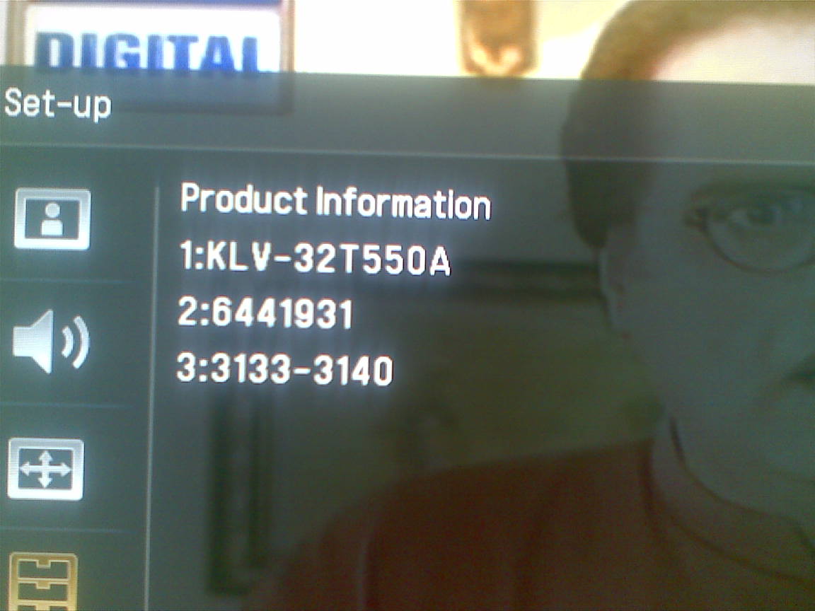

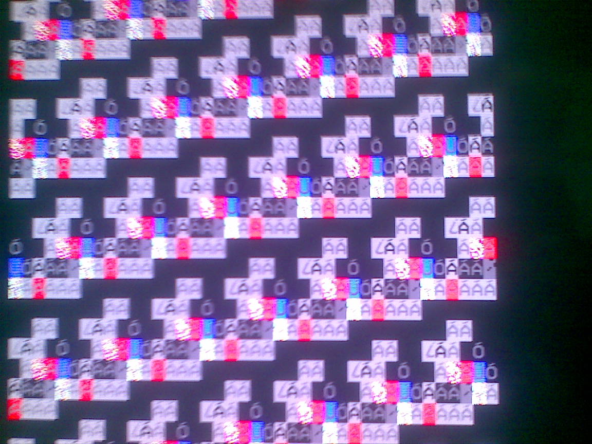

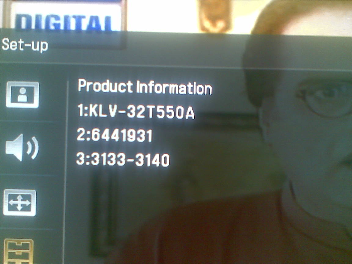

Had problems
1.works good without sound no audio
2.System Hang after 3 to 5 min running.
3.some times hangs R.C and front panel when chanage chanals with tac sound and also picture wash out with laft side broken imgae type.
Its looks frimware or els?

System hang is frimware problem.So some times hangs R.C and front panel and picture wash out..Change frimware and .

imran khan, а я думаю ПО здесь не причём. Возможно звуковой процессор по шине не отвечает, вот и зависает телек.Состав бы выложил,легче общаться было бы.

You are right, might be the bus chain command does not addresing micon with sound processor?

Yes,exactly this I had in view of.

I am posting regarding the issue of tv,This was my luck that same models came to my work shop this month,the first one fix by replacing the subsitute tuner
The 2nd one came with freezing fault,i post photos of above fault too
Now i did the every trick in 2 days what all friend say but its hard luck to remain unsolve mistry.
I want to upgrade frimware but could not find it.
A friend of mine in sony company says you should replace the main board and its cost PKR 10,000

Set fix by using dump of 32s550a
And reballing method on main chip.
