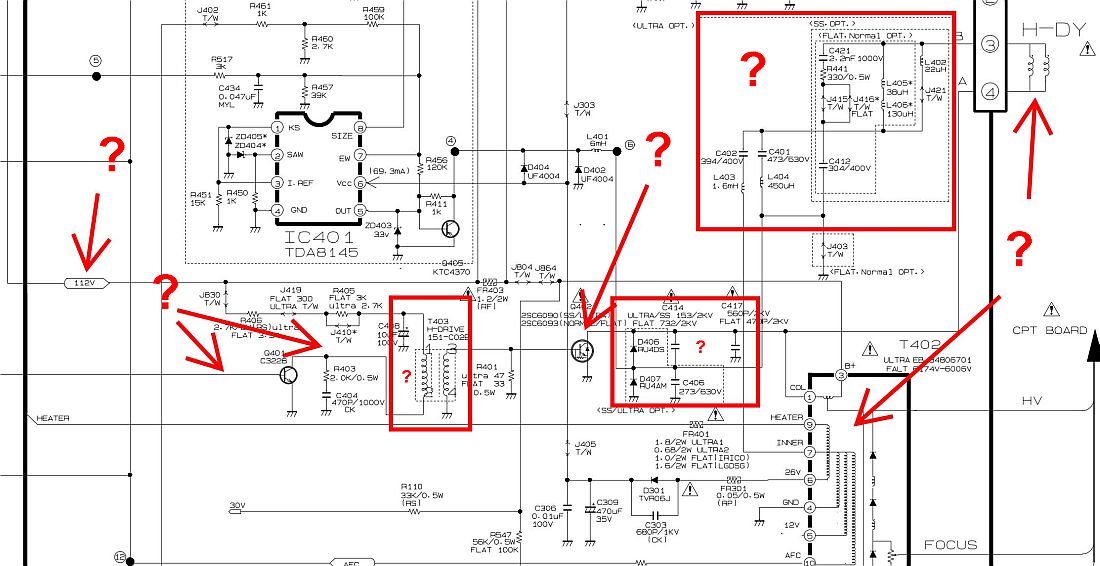

My friends its very important problem regarding this slim Lg tv
I have seen three tv in same fault.
I have found short circuit horizontal out put transistor
Now i replaced
Transistor C6093
capacitor
183j 2000v
474j 400v
10uf 100v
KA393
But when i trun it on again with 200w test lamp its short again .
Fly back tranformer tested good.
Any other friend encounter problem like this?

imran khan, What voltage of the feeding the Horizontal (+В) ?
ДОБАВЛЕНО 09/02/2013 22:21
imran khan, The Quality replaced C6093 real?

Сообщение #5 От 10/02/2013 01:51 цитата
main B+110 volts feed horizontal C6093 is real.
Its brun 6 transistor in a raw
I replace 183J 2000v but no help.

Сообщение #7 От 10/02/2013 10:39 цитата
imran khan, W-O-W
  LG chassis CW81B_03.jpg  110.49 КБ  Скачано: 1423 раз(а)
imran khan
Сообщения: 199
imran khan
Сообщение #8 От 10/02/2013 11:31 цитата
I try 6 different vendors for Hot and all goes short.
Photo points shows by mark red i have tested before.
Now i am going to replace all parts in Hot section.

Сообщение #9 От 10/02/2013 17:53 цитата
imran khan, The Breakaway of the chains declining systems?
R403, С404 тest or(and) change .

Куда он лампу втыкает? Если в разрыв цепи +B, то не должны HOT сгорать. И как FBT проверял? И что, на трех ТВ прямо один в один дефекты? Разговор слепого с глухим смех

Сообщение #12 От 11/02/2013 16:27 цитата
скорее всего у него не работает нижний кондер диодного модулятора

Сообщение #13 От 12/02/2013 18:47 цитата
Sorry for late reply
I have lost internet connection to the main server.
Now i let you know that i did what you all said but still not fix the problem.
ДОБАВЛЕНО 12/02/2013 19:57
when i use 200 watt test lamp
Between Collector of Hot to Fly back collector pin,
The picture show very short screen size left to right and viewable only in dark room light,
Horizontal out put went hot.

Сообщение #14 От 09/04/2013 02:34 цитата
At last i found bad jungle i.c LV3622.....SOLVED
