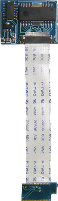

LA6508 (R) Replacement IC
http://www.goldenshop.com.hk/AI-trad/psx2hard/la6508r.htm
  la6508r.jpg  29.18 КБ  Скачано: 12795 раз(а)
