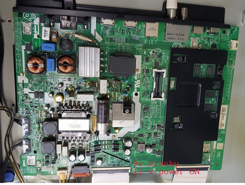

LED Samsung UE50NU7090U , no power , no led standby
amennone
Сообщения: 22
Сообщение #1 От 18/11/2024 01:32 цитата
Samsung UE50NU7090U
UHD TV - 7 Series
BN96-46823A
CY-NN050HGNV6H
By inserting power, on the diodes DM856...Dm859, there are 9 volts, when you press the power button the voltage is 12 volts, voltage present for a few seconds, then returns to 9 volts
The power LED remains off, always.
Reprogrammed Ic 503 = 25Q40 and IC 501 = 25Q80, downloaded from the site
The situation remained the same

Сообщение #2 От 18/11/2024 06:47 цитата
PFC 390v?
Матрица?
Подсветка?
