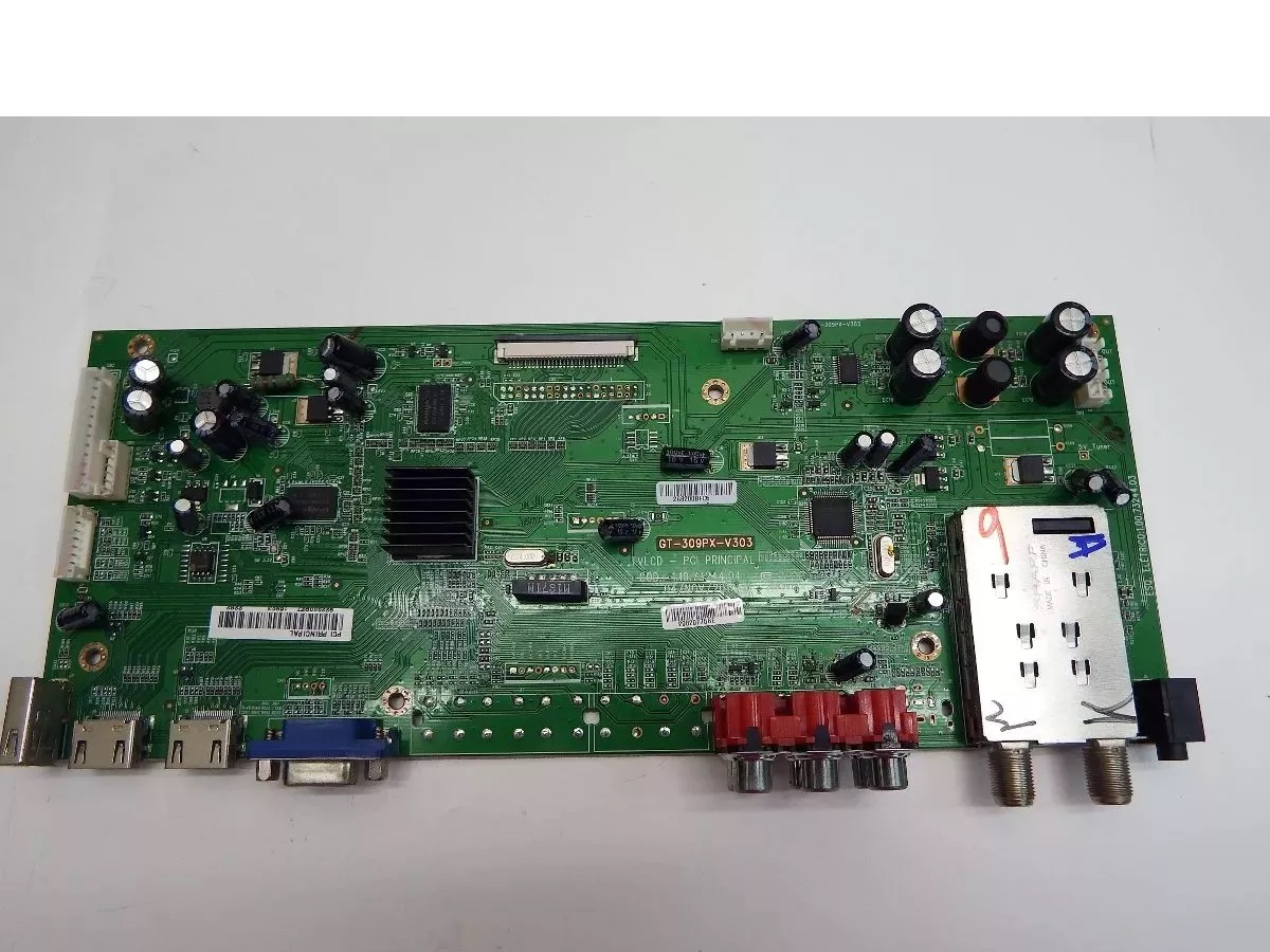

LCD CCE C320 нет включения
eletmoraes
Сообщения: 55
Сообщение #1 От 20/06/2017 16:36 цитата
MIP320G-A-T1
( power source : 1.00.73236.03 )
Main board code: GT-309PX-V303
Code 1.10.73244.04
tv нет признаков жизни
I even got the tv layout but did not have the components values. The only difference of the scheme that I have for the place board is the lack of connectors CN3 and CN7.

I measured the voltage at pin 8 of U1 (it should be NCP1606) and it is supplying voltage 0.0V. This voltage comes from + VC which does not charge any voltage.

do you understand Russian
ДОБАВЛЕНО 21/06/2017 23:02
The first photo, there is a connector on the bottom right, everything is written 5v, 12v, GND and so on. Do you need to measure these volts?
