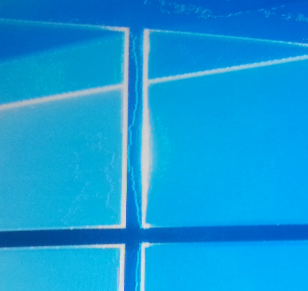

Assembly Process (continued)
Bonding of 3M ACF 5363 requires a three-part procedure:
Tacking the film to one substrate (pre-tacking)
Removing the release liner
Bonding the first substrate to the second substrate.
A pre-tacking temperature of 90°C under a pressure of
about 10 kg/cm 2 should be used. For automated ACF
application: Set the ACF pretacking equipment to deliver
the conditions provided in the Tacking and Bonding
Conditions Table above. Slight adjustment to these
conditions may be necessary for each application or for
different types of circuitry. For manual ACF application:
Cut the adhesive to the size of the flex circuit. Place the
adhesive on the flex and set flex on hot plate at setpoint
up to 90°C. Use roller to press adhesive onto the flex.
After allowing flex and adhesive to cool, remove liner.
Температура 90 давление 10кг.на см2 время 1сек.
