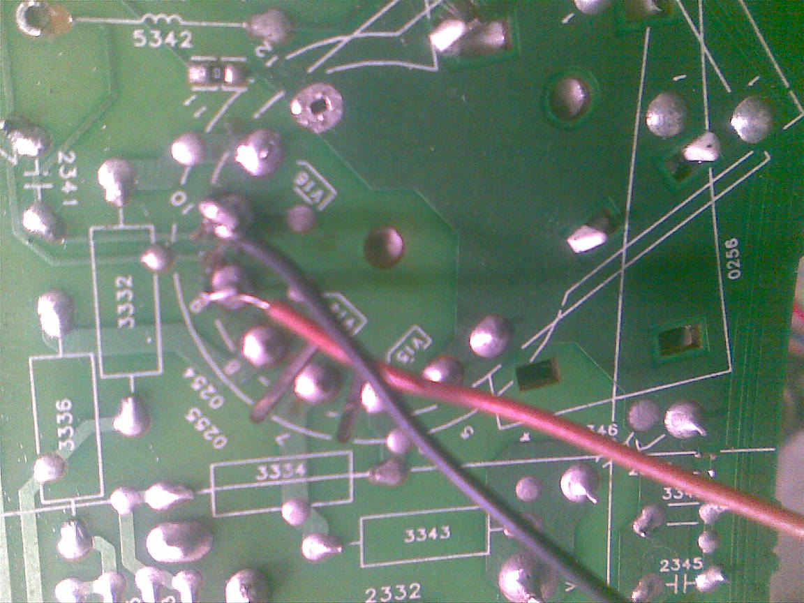

Update
I modify the Heater supply for faulty CRT
Internal short found on BK to G1
Trick works and the above tv set works fine now.

TV works good after one houre testing.
